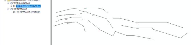

I have the following 2 dxf layers:
one is annotations one is polylines
I need to make the annotation closest to a polyline, its attribute.
Does anyone have any idea how i can do that?
I thought about utilizing buffers but i dont know if it's right.
