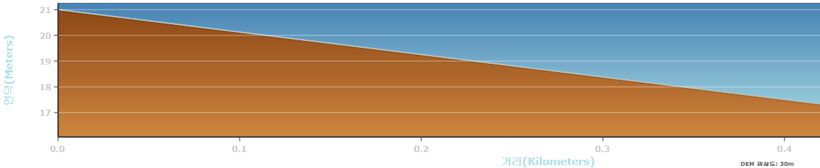

Hello,
I published the on-premise elevation profile service to portal for ArcGIS by using this URL below.
http://www.arcgis.com/home/item.html?id=0d47b17d3b884b9d977a6f76fc6bfcaa
The DEM which I used in the profile service has 30 meter spatial resolution.
I applied this GPServer to portal for ArcGIS and checked profile result in my Web application.
But the result has only two elevation values existing at the end of the line.
It seems like distance sampling was not processed correctly.

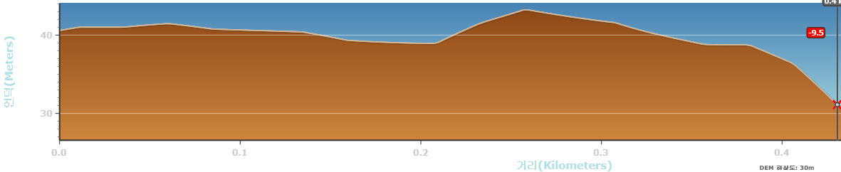

I attached the results both of on-premise service and ArcGIS elevation service for a comparison.
I want to see the elevation profile like ArcGIS elevation service, but I don't know what to do and what the problem is..
Especially, why does the result get only two vertices value...

Sorry for my bad English.
Just for references, I wrote this contents here.
I hope that anyone will not be confused like me.
I used ESRI elevation web app which link is below, created test app in my desktop.
http://www.arcgis.com/home/item.html?id=5c1c790f4f854e7089394ed61396d7da
An on-premise elevation profile in portal for ArcGIS
And the on-premise elevation service was applied in the test app.
There are two problems remained.
First one, a sampling distance value is not calculated well.
So I fixed the value 30 for the test.
The problem which I mentioned on the main content is disappeared.
But I should find which part will be modified in the future.
The other one, the elevation value of on-premise service is not correct.
It seems like spatial coordinate between on-premise service and digital photo(basemap) is not fitting well.

[on-premise service]
[esri service]
I will try to this process by using another DEM.
Any helps will be appreciated.
Thanks.
