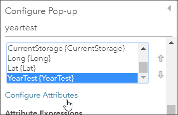

In Map Viewer Classic you should be able to set the decimal places and use of the 1000 separator after you add the hosted feature layer to your map. In the Content tab, open More Options (...) for the layer that has the field in question. Choose Configure Pop-ups, then Configure Attributes
Then make the appropriate adjustments, and save your map.
