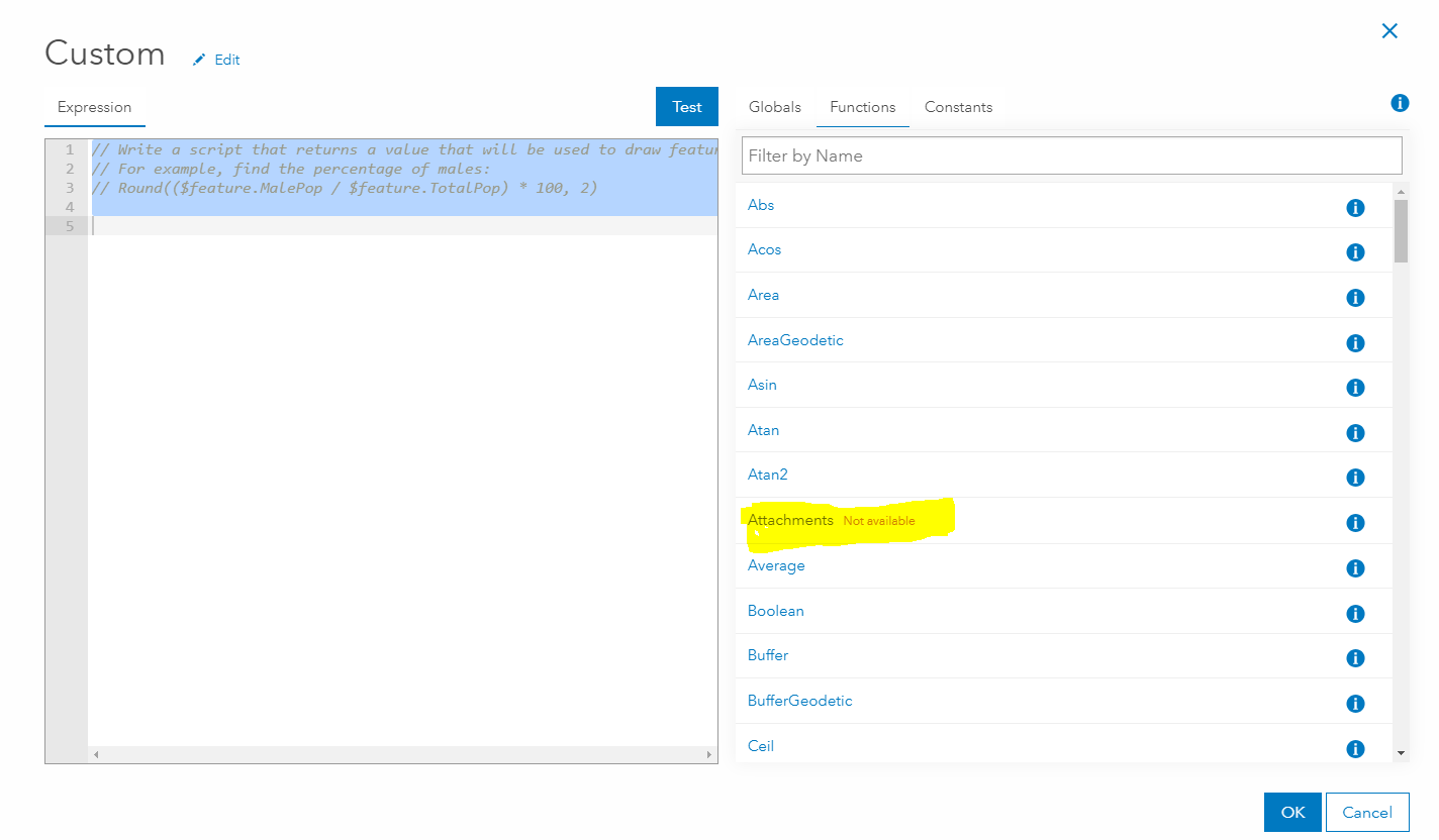

After reading this Blog Post on using Arcade to visualize your attachments in AGOL, I thought that I would explore some of our editable feature services in AGOL which have attachments. However, when I try to make an expression, I see that for my Feature, the Arcade Attachments function is not available.
Is there a setting in my editable feature service that is preventing this function to be an option? Something else that I'm missing out on?

The attachment function is available when calculation fields only currently. If you are trying to use it for symbology or pop ups it will appear as not available. Try calculating a field and then symbolizing based on the field.

Thanks Kelly, I did not realize that I had to do in conjunction with calculate field.
