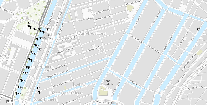

I have a feature layer called map in AGOL. I want to change the symbology, so I open arcgis Pro and I open this map and overwrite it with new symbols.

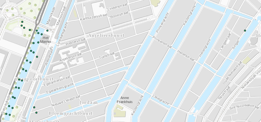

I see that the feature layer in AGOL is updated correctly. Only the views of this feature layers aren't updated at all.
Why is this and how can I make sure the views are also updated as well ?
PS: The legend is also not updated of the view layer.
Hosted feature layer (above)
View of hosted feature layer (below)

One of the whole points of feature view layers is that you can set separate symbology for the same data set. Because of this, data updates in the attribute table will apply to both the hosted layer and the view, but symbology differences are maintained. For this reason, it makes sense that symbology change to the hosted layer would not automatically update the symbology of the view layer.
You can change the symbology directly in ArcGIS Online, or change it in the same way you did for the hosted feature layer in ArcGIS Pro.
