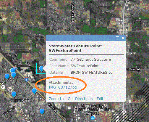

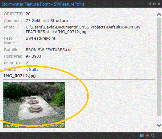

Hello,
I shared a geodatabase that has images loaded as attachments as a feature service, and I'd like the images to show in the popups when I click on one of the points (currently does this in ArcGIS Pro, but only shows as a link in AGOL -- see below).  I've seen several posts that involve copying url's, but I'd like to avoid having to do that so I can have the ability to overwrite the service when I add more points with photos in the future.  Is there a setting in AGOL that I'm missing?
AGOL:
AGOL popup with attachment link.
ArcPRO:

Hi David,
Currently the only way to display picture attachments in the pop up window is by referencing them via a link.
This document provides a workaround for the time being https://community.esri.com/docs/DOC-7445-show-attachments-in-web-map-popup?sr=search&searchId=337787...‌.
As you can add many different file types to attachments, you need to use the configure image option to display the option. This is an idea that is being considered, so please go ahead and support the idea on https://community.esri.com/community/arcgis-ideas?sr=search&searchId=b244bb37-feac-4a08-8f9e-12f3568...

DavidForbuss1
Thanks Kelly!  The script worked great : )
