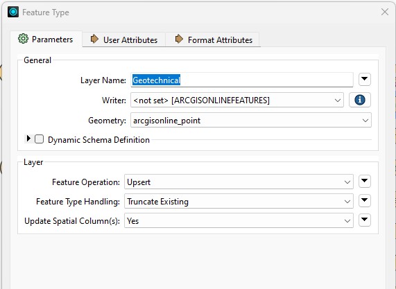

In FME Workbench 2023.1, I'm using the ESRI ArcGIS Online Feature Service Writer to update a layer in AGOL with data from a local fGDB. I have the writer configured as per the screenshot below.
After it runs, the layer in AGOL is visible when zoomed all the way out! (This was not previously the case).

I then change the FME writer to ‘Use Existing’ (and not ‘Truncate Existing’) and re-run the translation.
This time it works without affecting the AGOL layer visibility.
So I change the FME writer back to ‘Truncate Existing’ (and not ‘Use Existing’) and re-run the translation.
It breaks the AGOL layer visibility again!
I plan to use something like this to update many layers, and I cannot have them all visible when zoomed out. It would be a complete mess.
Am I doing something wrong? How can I update the data (including deleting features) without affecting the AGOL layer’s visibility?
(The issue occurs for both 'Insert' and 'Upsert'. I’m using ‘Truncate Existing’ so that if we delete a feature locally, this will cause it to be deleted on AGOL. Perhaps there is a better way to do this? But that would be another question entirely.)

Something in the FME Writer configuration is overwriting the service. It recreates the layer. This is what resets the symbology / layer settings. The same would happen in ArcGIS Pro if you published to overwrite an existing layer.
The fme documentation suggests there are additional parameters on using existing or creating services. It also advises caution with using truncate existing in some contexts.
You will need to review the other parameters and documentation so that the service is not overwritten if it exists already.
