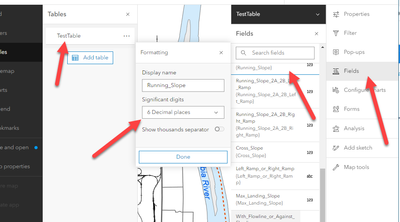

How/where are you displaying the table?
In Map Viewer, you can select the table, then the Fields option and change that on a per field basis:

Sorry, I should have mentioned that we're adding the table directly to Experience Builder (not via a Map). Based on some previous posts, it seems Experience Builder tables won't honor the field settings of layers in a Map Viewer. I just performed a test and this still seems to be true. So, I think we need to find a non-Map Viewer solution here.
