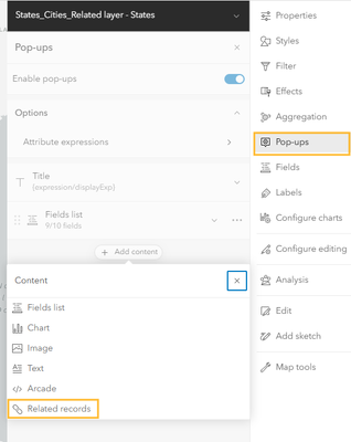

Hi @KeyHunter , thanks for posting a question. Map Viewer Classic has retired in the Q1 release in ArcGIS Online (Retirement Roadmap). Web maps we previously saved using Map Viewer Classic should now open in Map Viewer.
In your workflow, you mentioned configuring pop-ups for related tables. When we add a Feature layer or Web Map (with related layers or tables) in the Map Viewer, the Pop-ups panel will show an option to configure Related Records.
Are you able to open the Web Map in Map Viewer? Are you facing any issues with configuring Related Records in Map Viewer?

The issue is that the "Related Records" option is not visible or present. It was two days ago in Map Viewer it is not as of yesterday morning. I had "Related Records" as an option for a service with a feature service and a related table that I could toggle on Tuesday. I had a service ticket in (04116887) because it was available but returned an empty related table pop-up. I had just finished troubleshooting a workaround, where I deleted all of the original tables from the cumulative service that was added, and added each table one by one.
I was in the process of bringing in each table individually and reconfiguring the pop-ups with the related records function on pop-ups. The problem is not knowing how to configure related records; the problem is related records no longer exist as an option
Wednesday - related records were an option in the map viewer I was troubleshooting on at the close of business
Thursday - I started work to complete the individual table add and reconfigure related records and related records is no longer an option.
The Thursday AGOL update and removal of Classic make configuring related tables not an option. The update broke what worked in Map Viewer.
