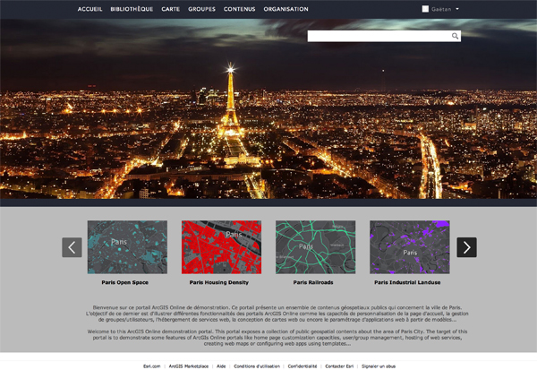

Beyond the standard features of ArcGIS Online, there are some advanced capabilities to customize the look-and-feel of your portal home page. Using CSS instructions, you can redefine some of the Esri default styles in order to get a more attractive page to welcome the users of you portal. Here is an example: http://demoagol1.maps.arcgis.com
If needed, I can provide the CSS source I used for this demo.

Hi Christopher,
I  uploaded here the CSS file that I used to customize this home page. You can test it by copying/pasting these instructions into the HTML code area of the "Banner" section. Hope it could help...
