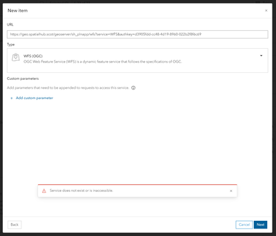

Hello,
I've been trying to add this WFS (https://geo.spatialhub.scot/geoserver/sh_plnapp/wfs?service=WFS&authkey=d3905fdd-cc48-4d19-8960-022b...) as item on AGOL. But I keep on getting an "Service does not exist or is inaccessible" as a response.
Oddly, it seems to work if I try to add it directly into a Web Map - but I would prefer to have it as an item on AGOL so I could use it for something I'm working on in experience builder.
I also tried to upload it as an item from ArcGIS Pro - but that doesn't seem to work as well.
Any suggestions on how I could get this to work?

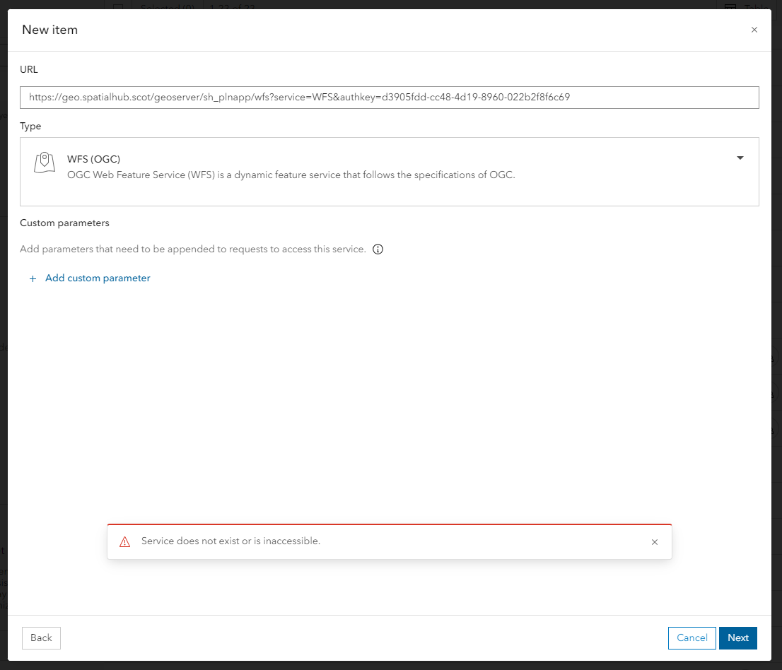

Greetings @SyedAlAziz24
I order to add the service to your Content page, remove the "SERVICE=WFS" bit from the URL leaving just the "authkey=d3905fdd-cc48-4d19-8960-022b2f8f6c69" as per the capture below:

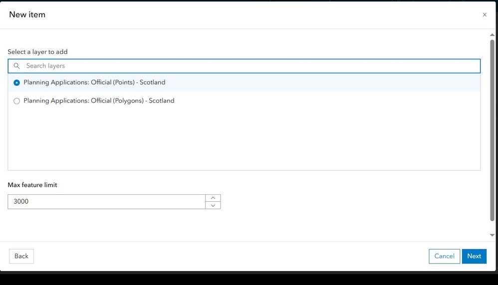

That will allow you to progress to select the layer:

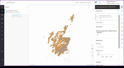

and complete the additional steps.  Here are the Planning Application points in the Map Viewer:
Give that a go and see if it works for you.
