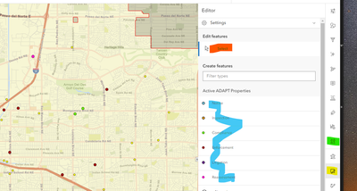

@MichelleK_NSLA  - are you setting up a basic webmap for editing? In the screen shot I've added here there are a few tools to use:
  • the green highlighted lets you set up a form for editing - this can really help simplify the edit process for end users and help you to enforce some quality control over the data entry. I'd look at this first.
  • the yellow highlighted button activates editing capabilities in the web map that pop out a panel where i've highlighted a couple of things:
    • the red highlighted 'select tool' lets you select an existing point, it opens up a form of attributes and if you hover over the point you select you can move it to a new location.
    • the blue highlighted bits are predefined categories that if you select on you can then place a new point for that 'type' on your map, then edit a related attribute form for it.
  • If you are developing an application there are some 'instant apps' that support editing and you might look at those. Otherwise if you are wanting to dive into the deep end of developing an editing app in Experience Builder, there are some trainings you can find that will help you get started.

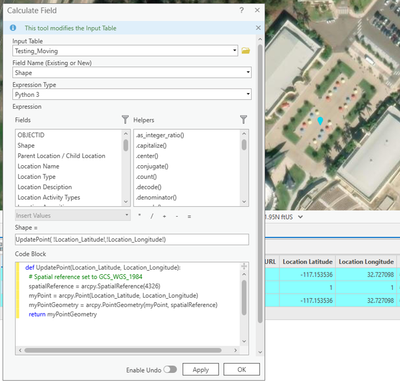

If you adjust the x/y in the attribute table, do you want the point geometry location to move to match that location?
You can do this as a field calculation within Pro
UpdatePoint( !Location_Latitude!,!Location_Longitude!)
def UpdatePoint(Location_Latitude, Location_Longitude):
  # Spatial reference set to GCS_WGS_1984
  spatialReference = arcpy.SpatialReference(4326)
  myPoint = arcpy.Point(Location_Latitude, Location_Longitude)
  myPointGeometry = arcpy.PointGeometry(myPoint, spatialReference)
  return myPointGeometry
