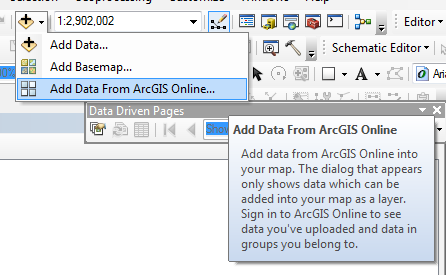

  • open it from ArcMap by 'add data from ArcGIS Online'

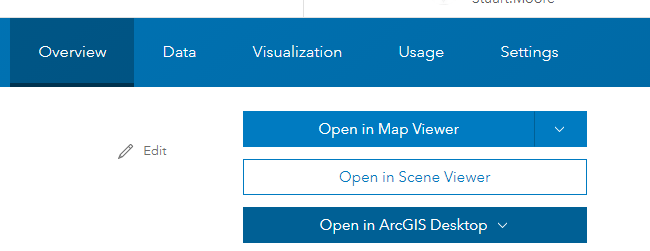

  • open it from the ArcGIS online, 'open in arcgis desktop'
both give the same results in that they only add the point layers and the tables are not added.
