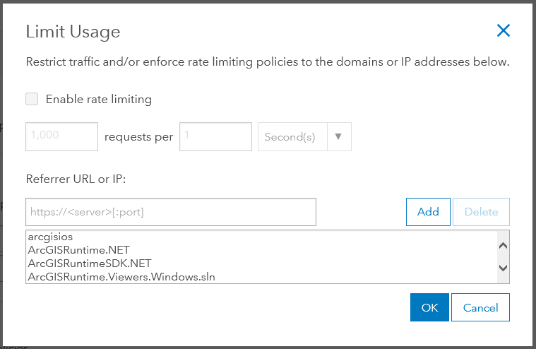

I am trying to add a Map Image Layer from our ArcGIS  account into ArcGIS Pro. The layer is shared with Everyone however to restrict how the service is used the Limit Usage has been set so that the service can only be used by certain applications / Our Organisational ArcGIS  built apps and maps.
The issue is when I try to add this service to ArcGIS Pro v2.2 via the link to our portal the item won't appear. What Referrer URL or IP address should be added to the box below to allow ArcGIS Pro v2.2 on my PC consume this service?
Limit Usage Box in ArcGIS

Used Fiddler and worked it out. looks like the referrer url: http://www.esri.com solved the problem.

Which applications do the entries in your image allow? I'm trying to get Field Maps to work.
