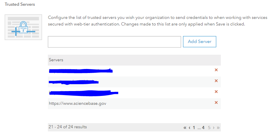

In your ArcGIS Online organization's settings, go the Security tab and add the domain for the geoserver to your organization's trusted servers list:
Once you've done that, you should see the prompt to sign in. I added the domain to my organization and confirmed the sign in shows:

It wasn't prompting me for credentials because my system admin added our domain as 'http', instead of 'https'.
Then it it still wasn't working because of a CORS error that we needed to resolve on our end. What a pain.
