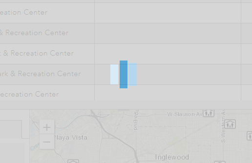

1. When I try to add a new report to the related table, it just gets hung up and never finished. It looks like this (I let it go for almost an hour before giving up).

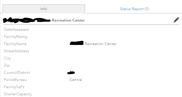

First, a screenshot of a feature with NO related table entry (see the status report tab)

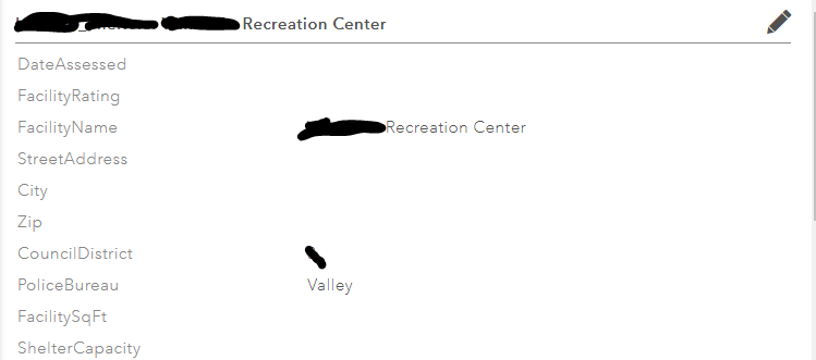

And now, here is what a record looks like when it does have a related record (notice no Status Report tab)
