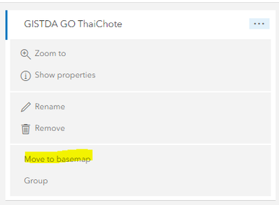

Are you able to see this option in Map Viewer to Move Layer to Basemap?

Added the WMTS into my content and could then add it into my web map as a layer then your answer came into play and bingo I now have a WMTS as a base layer! All a bit more involved than in the "classic" web map viewer

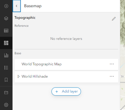

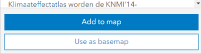

I don't think its more involved and we mirror the same actions as Map Viewer Classic. You can add a layer directly to basemap from item browser (just like Map Viewer Classic)
if you are doing a service you use this button to use as basemap which is also the same workflow in Classic.
An additional workflow that is only in Map Viewer is the ability to add layers directly into the basemap panel without having to use Move to Basemap from the Operational layer panel.
