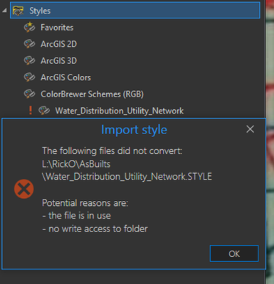

How do you bring in the downloaded symbols? The second link seems to explain how to create and save your own. Thanks.
RickOHaratheonly
If you try to bring in the stylx layer through the styles folder, arcpro doesn't seem to see the stylx file. Is this a glitch that is being addressed?
RussRoberts
Esri Notable Contributor
I am using 3.4 version of Pro and am not Seeing that issue under Styles folder in Pro Add > Add Style
RussRoberts
Bring them into Map Viewer after publishing or into Pro?
RickOHaratheonly
Yes, this is for Pro. I found my way to this string looking for downloading symbol options.
They don't seem to work in pro. I changed the file name to .STYLE and it will bring them in but not work. Pro won't find the .stylx layer.
RussRoberts
If you are using import it will show the .style files. If you are using the Add it shows the stylex
RickOHaratheonly
The style file doesn't seem to work. It won't find the stylx file. I'll just look for a different source. Thanks.
