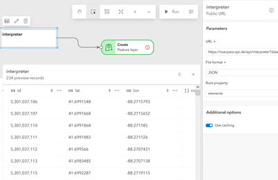

I've only played with Pipelines a little, but it does look like you could get it to work. Here's me using a query to pull bench nodes for my area.

Thanks again Josh, could you provide a link to the application you are using in the screenshot?
