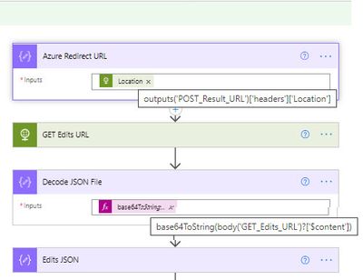

The url should look something like below. You might want to replicate the call to /changeFiles in Postman or in the broswer at the REST endpoint. If you can't get the file information to come back you might need to log a support request with ESRI.
https://arcgisazureprod1.blob.core.windows.net/replicafiles/0cf6418sss4b4461b166b47d8b0b07c4.json?se...
 I grab the url from the header of the reply. You can turn around and make a GET request to the full url.
The content returned will need to be decoded as it it sent in in base64:
Cheers!
Cheers!

That actually worked for me. I have access to edited attribute values now. Grateful to you for your time and effort, I would have never guessed this workflow. Thanks so much.
