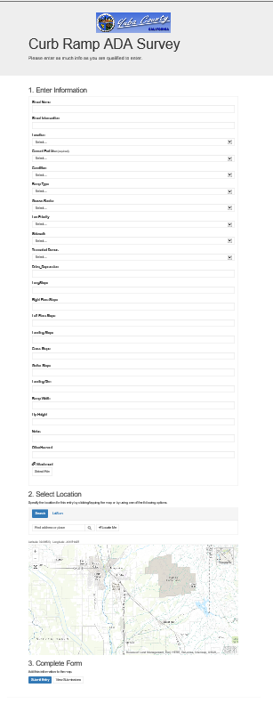

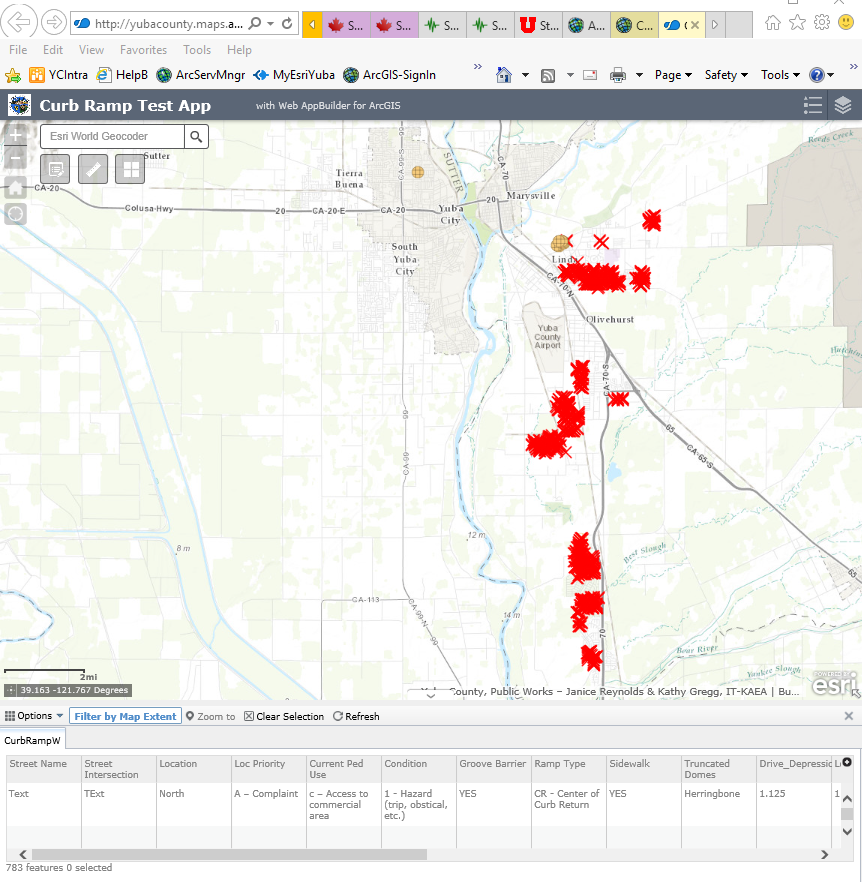

KATIEATKINSON
I have tried everything I can think of I have the maps able to be editable on the PC but the app is not showing up in Collector and the map that is showing up the layer is greyed out will not turn on.
I have created a working Enterprise Geodatabase and have my working layer in it.
I have tried 2 different apps the first is the ESRI Template for collecting DATA it works great from the PC. When I created one using hosted data it did work in collector however it did not have the drop down functionality that I desired. SO with this app working great from the PC I tried to host an app on our Server. I use another template for this and again it works on the pcs for everyone I sent it to they have been able to make edits; so I know the layer is editable. SO WHY is it still not showing up in Collector? PLEASE HELP!
RussRoberts
Esri Notable Contributor
Only the webmap will show up in Collector app. The Collector app might not be able to access the service if your server is not exposed to the network the device is on.
MichaelMiller2
It sounds like you are expecting an app to be visible in Collector. It does not use apps, it uses maps.
