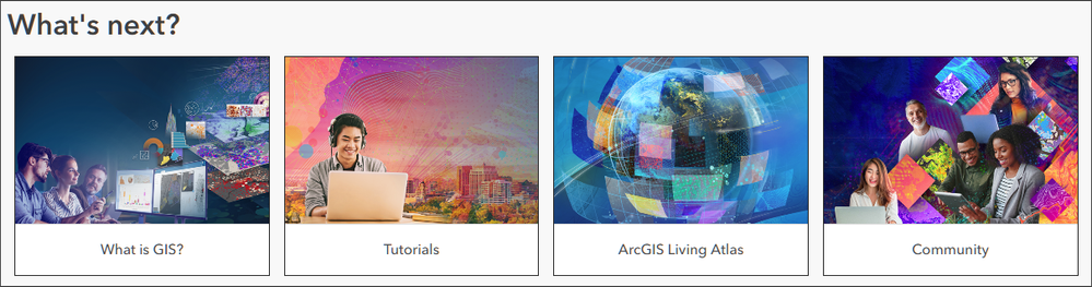

Where can I get help or learn more?

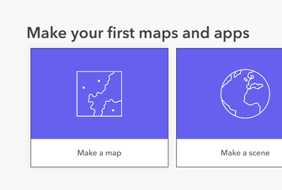

When you sign in to your public account, you'll see a home page with links to resources to help you get started. The first row of resources steps you through the basics of creating maps, scenes, apps, and stories.
The second collection of resources delivers links to general GIS questions, tutorials. ArcGIS Living Atlas, and this community place.

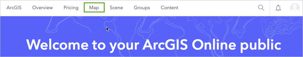

I have created a public account to create a test map.
However, when I follow the instructions, I can't get to Map Viewer because there is no App Launcher on my screen and nothing I have found that explains what to do in this situation.
AdenaSchutzberg1
@CraigODonnell
Once you are signed in to ArcGIS with your public account, to access Map Viewer, click Map from the ribbon.public_acct_mapviewer.png
