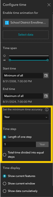

It's very difficult to display yearly demographic data in a time-enabled layer when Date fields express as a date in time rather than a just a year. I have school district enrollment data that is compiled by year. I want a time slider widget to just show 2023 (for the 2023 school year) instead of 8/31/2023 7:00pm. I can't be the only person who has data that  is representative of an entire year rather than a singular point in time!
The time slider widget in Experience Builder can't be configured to not show a span of time. Even if you put the ends of the sliders together while editing the app, they default to span a year from one date to the next in the live app. The problem with this is it'll show both years of data at the same time.

@mnelson My org doesn't have Enterprise so I'm just working in AGO and Esri's June 2025 update to ExB actually gave me what I've been waiting for for 2 years! From what I understand, it takes a bit of time (no pun intended) for upgrades in AGO to be made available in Enterprise. Fear not! Better time settings are on the way. 😁
Minimum time accuracy setting in ExB set to Year.Minimum time accuracy setting in ExB set to Year.
How the timeslider widget looks like with the recent ExB update (the minimum time accuracy set to Year).How the timeslider widget looks like with the recent ExB update (the minimum time accuracy set to Year).
