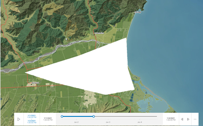

Vlad
@Andrew--Johnson
Thanks for the reply. I've checked several times Instant App on the multipacth feature layer (groundwater levels) and the TimeSlider still doesn't work with it.
However, Map Viewer recognizes the DateTime field in the multipatch feature layer:
Andrew--Johnson
@Vlad Ok, I just tried on my end with my own multipatch data and i'm seeing the same thing. The doc isn't clear on this so i'd recommend posting a question in the Instant Apps channel so someone from that team can comment on this > https://community.esri.com/t5/arcgis-instant-apps-questions/bd-p/arcgis-instant-apps-questions
