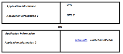

HTML returned through Arcade would help us a TON.  We are currently trying to intersect different featuresets for permit data, in a one-to-many way, and return information and a URL for each permit.  Without the ability to pass HTML, we end up with an unclickable URL.  Even if we break out the URL into its own expression, and pass that separately, since there could be many URLs, it joins them into one, making it unusable.  The HTML table ends up looking like:
If we could either build the link or table with HTML, our problems would be solved!
I know @XanderBakker and @KellyGerrow have had some luck in other applications, but none of those solutions seem to work in this instance.
