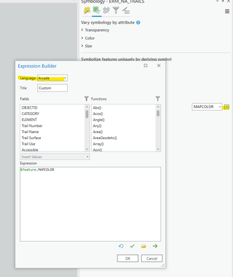

When you go to that layer in Pro click on the expression icon next to Map Color and switch the dropdown from VBScript to Arcade. Then publish the map up and it should look like the one I posted back into the group.

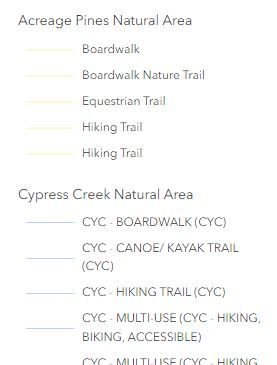

@RussRoberts Wow, big big thanks, that worked!  Is that basically what you did when you used AGO-Assistant?
Another question, in Pro or AGO, or using AGO-Assistant, is there a way for the legend to reflect the color?  Instead it seems that they're just some random color.

Yup a while back as things were still being worked on across teams I had to use assistant to get the properties to be in arcade and there was 1 or 2 other areas where we on the web side weren't fully supporting. Now with the above case just using Pro (I used the latest version here) and making sure when you set the field to go through the expression builder just to explicitly set it as arcade instead of vbscript.
When using these field connected primitive overrides both clients are currently limited with the legend support and we cant extract that color. I don't have a release when this is supported unfortunately.
MatthewKing
@RussRoberts bummer about your 2nd paragraph b/c that kind of stops me in my tracks.  I really need the legend to reflect the trail colors.  I'll submit a separate AGO Idea for that.
Thanks again for your help.  While in the end I'll need to find an alternative (or do the symbology of all 130+ trails manually) this was helpful and I did learn something new.
