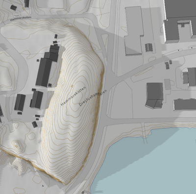

I made the hosted scene-layer white and set it to 99% transparency. Buildings shadows will no longer go through small hills etc:
Without terrain as multippatch, building shadows goes through a hill:SveinungBertnesRheim_0-1682506488108.png
With terrain as multipatch, the hill casts its own shadow, no false building shadows.SveinungBertnesRheim_1-1682506488156.png
