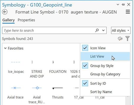

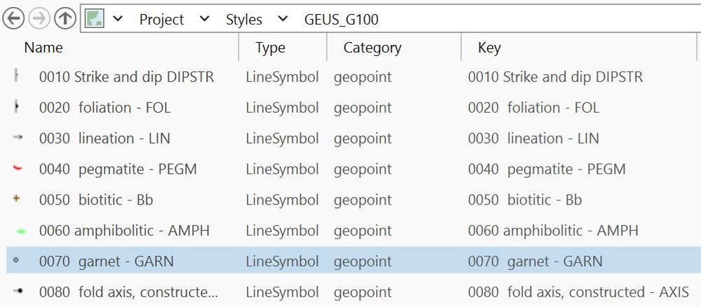

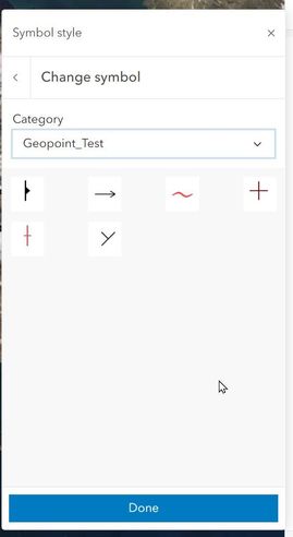

When a new symbol style is shared to AGOL, all the relevant properties from the symbols are missing. This is properties such as Name, Type, Category and Key.
This is critical as some symbols might have almost identical figure and need to be destinquised from its Category or Name. Also, when a larger web style is shared, it is difficult to find the specific one when only the icon is shown.
We would propose that the same properties are shown in AGOL as in ArcGIS Pro with the option to switch between Icon View and List View. Furthermore, a search function would be appreciated to easily find the relevant symbol.

Searching is on our current roadmap for symbol styler.  Also showing the name through a tooltip is planned as well. Switching to a detail view is currently not on a near term feature but thanks for the feedback!
cbp-geus
Hi @RussRoberts. That's good to hear.
A detailed view would help a lot when having an extensive symbol style. For our geological maps of whole Greenland we have over 500 symbols with different categories and we want to upload this as our default web style for our geological maps.
