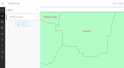

@RussRoberts I'm still only seeing centroid label placement in both of my AGO orgs using the new Map Viewer. Would you suggest I contact  Tech Support? Here is an example using a test layer I just published to AGO:
Labels enabled:
Then, after panning the map - no labels:
RussRoberts
@MikeSchonlau currently the label is placed at the polygon centroid and is not updated to a centroid to where the remaining polygon geometry is displayed after a pan/zoom.  This is currently the only option for label placement for polygons at this time.
