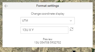

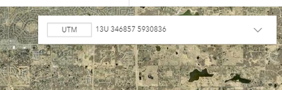

I'm assuming you mean you want to click in the map and get the coordinates for a particular point.
If so, then click on Location on the right side (light) tool bar.
This will bring up a popup
In this case my coordinate system is set to 13U.
To change this, click the down arrow and then Format Settings (the gears) in the bottom right corner.
This shows the coordinate system as 13U
To change this, simply change the 13 to a 12 to get coordinates in 12U and then when you select Capture Mode it will provide coordinates in the UTM zone you typed in manually.

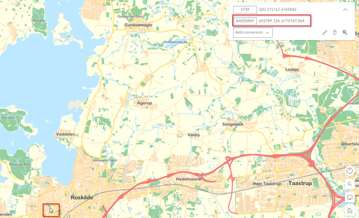

LauraMajaStenbækFløytrup
@temprobertcottreau131313
Both @ThomasBalstrøm and I get the wrong X value when doing this. Are you experiencing the same or is it correct when you do it? Perhaps we're missing a step or something.
See the image below; the value is supposed to match the values shown next to the Basemap format:
