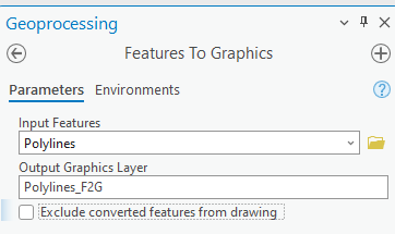

Do you have access to Pro? If you import the web map into Pro you can run Features to Graphics and that will create a feature class that you can publish as a hosted feature layer.
