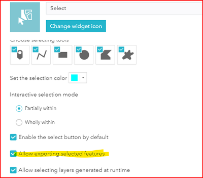

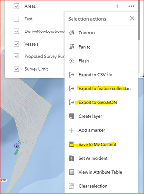

jcokin1
Not a perfect solution but close enough for now.
We were just not seeing and customizing the correct widgets in webAppBuilder. 🤦‍ use the following two widgets and you can draw / sketch and then export it out a GeoJSON.
Turn on both the Select widget and the Drawing widget. Whatever you draw with the drawing widget will become a layer that is selectable in you apps TOC.  You can then use the Select widget but make sure to turn on allowing exporting from the options/customization part of the widget. Do this with caution as any layer in your webapp TOC can be then selected and exported out.
Once your drawing is selected you can export it out as GeoJSON file and then convert it to .shp file. There are tons of free websites to convert or just simply run it through ArcGIS Pro to make your .shp file if needed by the client.
Still would be nice in the future and to go the extra step and lets us select .shp as an option for export. Also, limit what layers can and can not be exported for security as part of the enhancement.
