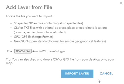

As a workaround if needed... If you need to do this now, Map Viewer Classic supports adding GPX files directly, via browsing or via drag-n-drop.
The GPX file is converted to an internal feature collection in Map Viewer Classic, but you can visualize those in Map Viewer. Those features are stored "inside the map" and can't be used in other maps.
However, you can create a hosted feature layer out of the feature collection GPX files that you can use in other maps by using Save Layer in Map Viewer Classic, then publishing the newly created saved layer item.
There are also a number of utilities that you will find online that can be used to convert GPX files to CSV and other formats, and you GPS device may also have an associated program that can do the same.
