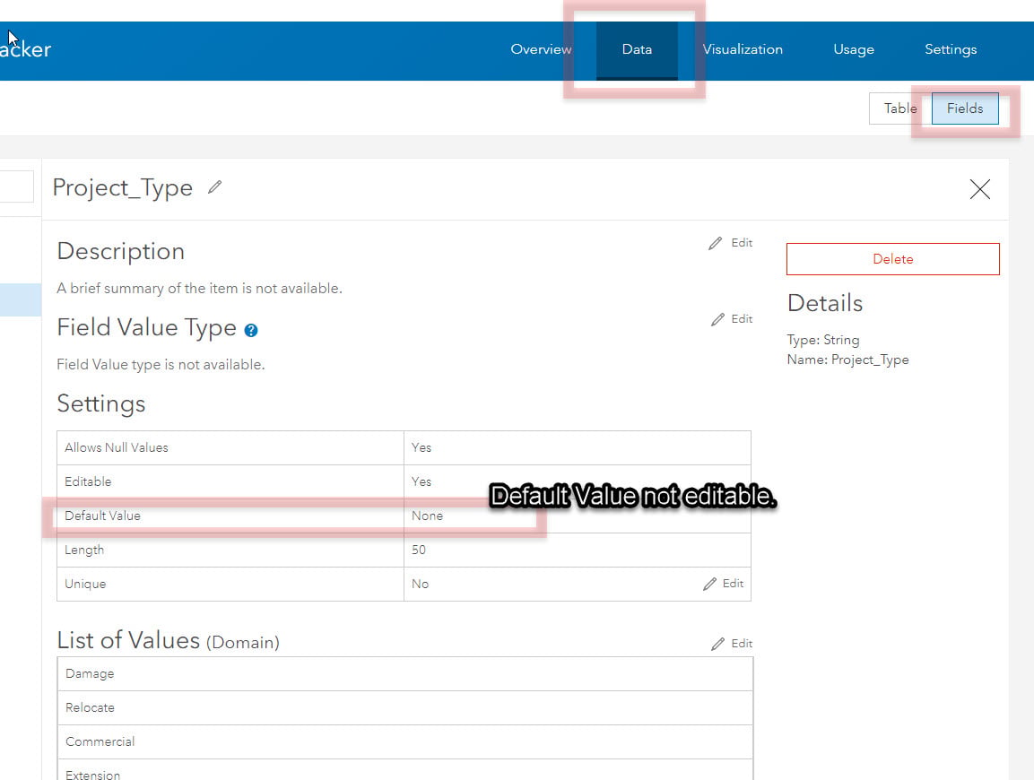

At this time, if you set up a Default Value for a field upon creation of a Hosted Feature Service, you have to delete and re-create the field to remove the default value.
Please allow the functionality to re-configure the Default Value of a field post hoc.
