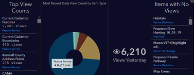

Yes, the end result of that is very much like what I hope ESRI will provide for everyone through some sort of admin dashboard.
Thanks for posting your script @jcarlson
