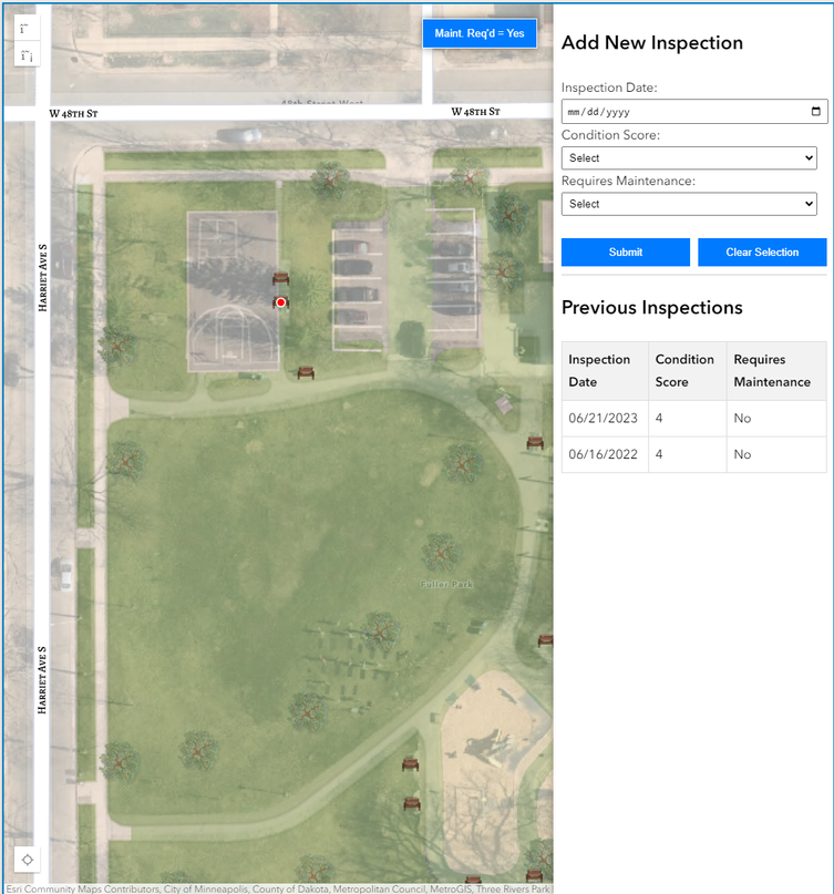

I was able to create this functionality with the ArcGIS API for Javascript.  I had to create this app to enable this workflow.  I am not a developer or know how to code javascript very well, but CHATGPT does.  So, I told chatgpt what I wanted to do and it gave the code to create a website where I can now select multiple features and send the same inspection to all of them in the related inspection table.  If anybody needs any pointers on how to do this, let me know.
Here is the basic mock-up that worked:

@ArmstKP I'd be interested to see what prompt you gave to chatGPT.
ArmstKP
@RicciLucas I prompted ChatGPT that I wanted to select multiple features on the map, obtain the GlobalID from those features and create a new record for each in the inspection table.  I gave ChatGPT the feature layer url and the inspection table url and i told it the fields I wanted to collect in the inspection editor panel (the side panel in the above photo) and what fields to send those to in the inspection table (mapped the fields).  If your layers aren't public, it will add an ArcgGIS Online login when you first run the code/open the website.
I used this html editor to paste the code into when ChatGPT generated it, and just click the green run button:  https://www.w3schools.com/html/tryit.asp?filename=tryhtml_basic

@ArmstKP nice! Do you have a link to a jsfiddle of that?  Hehe it is a little unnerving we can now be automated, but I suspect a lot of engineering around platform limitations like this will keep us gainfully employed at least another decade. 😄
