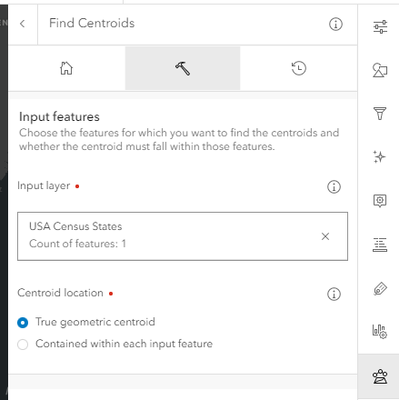

Can you make use of the Filter option to only analyze a subset of your data?
If you use Filter in Map Viewer, only those features that meet the filter criteria will be used in the analysis.
For example, when I filter the layer USA Census States to only Minnesota, only that feature is used in the analysis.
