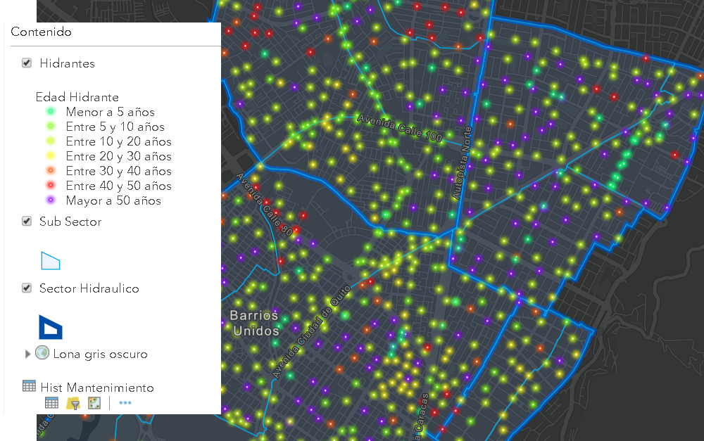

Consider we have a web map with several layers and a table:
  • Hidrantes is a point layer with hydrants
  • Sub Sector is a polygon layer with a sub division of the area of interest
  • Sector Hidraulico is a polygon layer merging sub sectors into hydraulic sectors
  • Hist Mantenimiento is a table with the historic maintenance records for each hydrant
First of all, let’s apply some Arcade to visualize the hydrants based on their age. This was already possible in the previous release, so no new things here yet. We have the installation date stored in the field FECHAINSTALACION and we can use the DateDiff and Now functions to determine the age in years, which happens on the first two lines. After this we classify the value into significant ranges:

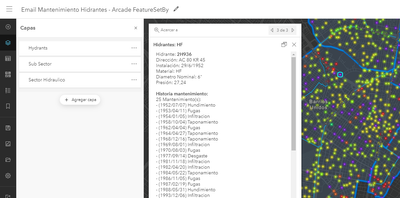

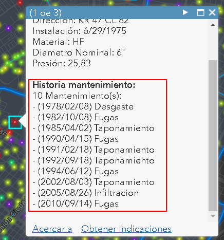

We would like to show in the pop-up window of each hydrant the list of all maintenance carried out on the hydrant. Both the maintenance history table and the hydrant layer contain the ID of the hydrant. The table also contains the dates and type of maintenance.
In the configuration of the pop-up of the hydrants we can add an Arcade expression like this one:
var tbl = FeatureSetByName($datastore,"Hist_Mantenimiento");
var codigo = $feature["COD_HIDRANTE"];
var sql = "COD_HIDRANTE = '" + codigo + "'";
Console(sql);
var mantenimientos = Filter(tbl, sql);
var cnt = Count(mantenimientos);
var historia = "";
if (cnt > 0) {
    historia = cnt + " Mantenimiento(s):";
    for (var mantenimiento in mantenimientos) {
        var txt_fecha = Text(mantenimiento.Fecha_Mantenimiento, ' - (Y/MM/DD) ');
        var txt_man = txt_fecha + mantenimiento.Mantenimiento;
        historia += TextFormatting.NewLine + txt_man;
} else {
    historia = "No hay mantenimientos";
return historia;
First of all, we access the table with the maintenance history and assign it to a variable tbl. Then we read the id of the current hydrant for which we want to create the pop-up. We define a SQL expression using the hydrant ID which is then used to filter the history table. The result is stored in a variable called mantenimientos. We can do a Count to obtain the number of maintenance carried out on the hydrant. If the count (cnt) is larger than 0, we start reading out the details and construct a list of maintenance including the date and type of maintenance.
The result will appear like this after we configure a simple custom html to show the attributes and result of the Arcade expression in the pop-up:

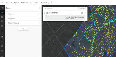

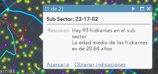

Now let’s continue with doing something with these new Arcade functions to get some data hydrants at the sub sector level. Since the number of maintenance obviously depend on the age of the hydrant, it would be nice to get some details on this at the sub sector level.
In the pop-up configuration of the sub sectors we can add the following Arcade expression:
var fs = FeatureSetByName($datastore,"Hidrantes");
var hidrantes = Intersects(fs, $feature);
var cnt = Count(hidrantes);
var edad_tot = 0;
for (var hidrante in hidrantes) {
    var edad = DateDiff(Now(), hidrante.FECHAINSTALACION, "years");
    edad_tot += edad;
var resultado = "";
if (cnt > 0) {
    var edad_media = edad_tot / cnt;
    resultado = "Hay " + cnt + " hidrantes en el sub sector";
    resultado += TextFormatting.NewLine + "La edad media de los hidrantes es de " + Round(edad_media, 2) + " años";
} else {
    resultado = "No hay hidrantes en el sub sector";
return resultado;
This expression will:
  • Access the Hydrants layer
  • Do an intersect with the current sub sector feature
  • Count the number of hydrants in the sub sector
  • Calculate the age for each hydrant and some all ages
  • Calculate the mean age of the hydrants and format the text with this information
The result will appear like this:
In this case there are 93 hydrants in the sub sector and the mean age is 20.64 years.

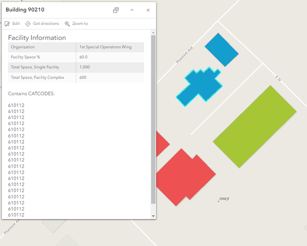

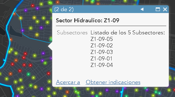

This is fun, but can we also show the names of the sub sectors that are contained by a hydraulic sector using these new Arcade functions? The answer is yes. Let’s add the following expression to the hydraulic sectors:
var fs = FeatureSetByName($datastore,"Sub Sector");
var subsectores = Intersects(fs, $feature);
var cnt = Count(subsectores);
var resultado = "Listado de los " + cnt + " Subsectores:";
for (var subsector in subsectores) {
    resultado += TextFormatting.NewLine + subsector.IDSAP;
return resultado;
Just access the sub sectors layer and Intersect with the current hydraulic sector and voila…, rights? No, not so right. When you use an Intersect between two polygon layers, it will probably return too many features due to the fact that when two polygons have a matching boundary they will probably be included in the result, leading to more sub sectors than we want.

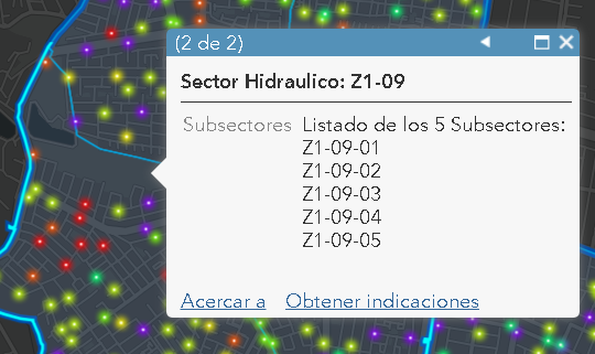

A way to avoid this is to use a small negative buffer on the hydraulic sector and do the Intersect with that buffered geometry like this:
var feature_buf = Buffer($feature, -100, 'meters');
var subsectores = Intersects(fs, feature_buf);
return resultado;
Notice the Buffer with a negative distance that is created on line 2 and used on line 3 to get the rights polygons.

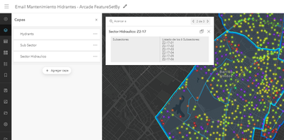

The resulting pop-up will show like this:
To be honest, I don’t like the unsorted list of sub sectors, so let’s order this list using OrderBy:
var subsectores = OrderBy(Intersects(fs, feature_buf), 'IDSAP ASC');
return resultado;
Which will result in a sorted list of sub sectors:

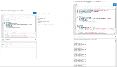

RickardNasstrom
Hi @XanderBakker ,
Thanks for a great example and workflow. I am basically trying to replicate this workflow, but I get stuck when trying to summarize the info in my subsectors in MapViewer Beta in AGOL. When using MapViewer Classic in Portal it works.
I wanted to use MapViewer Beta for this, and since our Portal is currently on 10.8 I shared the data through a distributed collaboration to our AGOL account. I get the previous expressions for summarizing related table records for individual assets to work.
In my Arcade window in MapViewer beta it all looks great and I get a correct looking result, in my pop-ups however, I only get a result when there is no objects in the sub-sector.
This is what it looks like when I write my expression. - It recognises dates and the number of objects.
I am quite novice in terms of using Arcade, but my guess here is that it has something to do with me not accessing the data correctly, however it seems strange to me that I get a result in the Arcade window?
Here is my code: (basically just copy/paste frome yours)
var fs = FeatureSetByName($map,"Belysningsstolpar_Gävle");
var belysning = Intersects(fs, $feature);
var cnt = Count(belysning);
Console(cnt)
var age_tot = 0;
for (var lyse in belysning) {
var age = DateDiff(Now(), lyse.Installationsdatum, "years");
age_tot += age;
Console(age_tot)
Console(lyse.Installationsdatum)
var resultat = "";
if (cnt > 0) {
var age_media = age_tot / cnt;
resultat = "Det finns " + cnt + " Belysningsstolpar i subsektorn";
resultat += TextFormatting.NewLine + "Medelåldern är " + Round(age_media, 2) + " år";
} else {
resultat = "Inga belysningsstolpar i subsektorn";
return resultat;
Could it be accessing the data or is there something different when you use MapViewer Beta?
Best Regards
Rickard
XanderBakker
Esri Esteemed Contributor
Hi @RickardNasstrom ,
It is strange that it would not work in Map Viewer Beta, since it should. I just did a test with the example that I constructed for this post and it works as expected in the Map Viewer Beta:

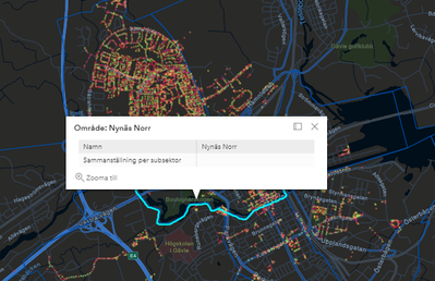

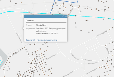

RickardNasstrom
Thanks for testing and your quick reply. I just tried with the same feature layer in AGOL Classic MapViewer where it works.
This is how my pop-up looks in Beta
And here is in classic:
I'll try to get rid of my special charachters, see if it helps.

ChrisMartin123
Hi @XanderBakker
This post has been super helpful. I've read through it and all the comments. I have a very similar use case but need a slightly different output.
I have a polygon layer of buildings and a table of category codes that are included in a relationship class. The field that links them is an ID field which is called "UID" in the buildings layer and "UID_Child" in the category code table. I am trying to edit my output so that in the case of multiple occurrences of the same category code within one building, that code would be listed once along with a count of how many times it occurs, rather than listing duplicate codes. Here's my current code:
//identify related table data
var related_table = FeatureSetById($datastore, "11");
//filter relate table for records matching unique ID
var filter_query = "UID_Child = '" + $feature["UID"] + "'";
Console('filtering related data records')
var related_data_filtered = Filter(related_table, filter_query);
//count records matching UID in related table
var related_data_filtered_count = Count(related_data_filtered);
var output = []
Console('records filtered: '+ related_data_filtered_count)
//push catcode value from related data table to output
if (related_data_filtered_count > 0) {
  for (var related_data_row in related_data_filtered) {
    Push(output, related_data_row.CATCODE)
} else {
  return "No Related Records."
Console(output)
And here's what the popup looks like:
So for this feature for example, I would want it to read "610112 (10 or however many times it occurs)" I think I need to use a for loop to count how many times each catcode occurs. I've tried a ton of different variations with no success. I'll put one sample below. Do you have any ideas?
