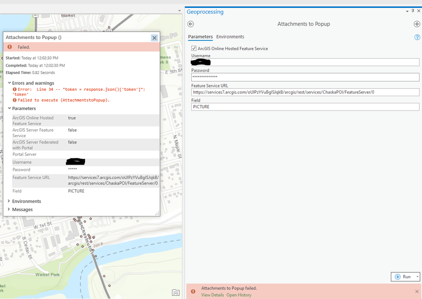

I'm having an error when running the script in Pro. It is saying that my web layer doesn't have attachments, but as you can see on the right-hand side of the image, that it does have attachments.
Screenshot
JakeSkinner
Esri Esteemed Contributor
Orca Maritime‌ can you share the service to an AGOL Group and invite my user account (jskinner_CountySandbox)?

Hi Jake Skinner‌, I'm getting a similar error. I've checked that my feature service is enabled for editing and have added the index to the end of the URL. Any ideas why I'm getting this error?
JakeSkinner
Samantha Griffore‌ what type of authentication are you using for ArcGIS Online?  For example, are you using built-in users, Active Directory, ADFS?  This tool currently only supports built-in and Active Directory.
Also, could you share the service to a Group and then invite my user account (jskinner_CountySandbox)?
SamanthaGriffore
Jake Skinner‌ Invite has been sent. I believe we use local users, but I'm checking on that.
JakeSkinner
Samantha Griffore‌ your feature service URL is incorrect.  It should end with /2.  Here is how I had the tool setup:

Thanks Jake Skinner‌. Unfortunately, still getting the same error. At this point it's not crucial, but a nice to have. I'll let you know if I figure it out.
URL:
https://services6.arcgis.com/ubm4tcTYICKBpist/ArcGIS/rest/services/NR_Projects_Specific_Location/Fea...
Error: Line 34 -- "token = response.json()['token']": 'token'
Completed script Attachments to Popup...
Failed to execute (AttachmentstoPopup).
DambéSANWOGOU

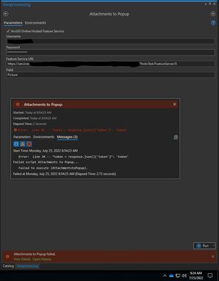

TimSolomonson
@JakeSkinner ‌, i'm having the identical issue @SamanthaGriffore is having and haven't been able to resolve the issue.
I've added you to a group with the same title as this post.  the servicelayer in question should be shared to you in there.
Error message:
JakeSkinner
@TimSolomonsonyou need to enable editing on the Feature Service.  You can do this by going to the Settings.

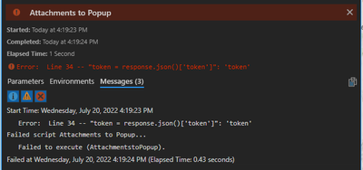

DickieRigdon
Hi @JakeSkinner ,
Hope you're still following this thread. I'm getting the same error for line 34 as @TimSolomonson and @SamanthaGriffore.  I do have "Editing" enabled on my layer.  I used /0 in my url as that is what my layer has. Thanks for any tips. -Dickie
JakeSkinner
@DickieRigdon if the service is an AGOL hosted feature service, can you share the service to a group and invite my user account (jskinner_CountySandbox)?  I can take a look to see what's going on.

@DickieRigdon,
The tool is working from me on my end.  Can you send a screen shot of how you have the GP tool configured?
DickieRigdon
@JakeSkinner
Tried it again, same error.
JakeSkinner
@DickieRigdon check your username.  It is case sensitive.  For example, if I try jskinner_countysandbox, I receive the same error.  However, jskinner_CountySandbox works.
DickieRigdon
@JakeSkinner  Success!  That was it.  I was using all lower case in toolbox username.  Funny, I can login though to AGOL using all lower case.

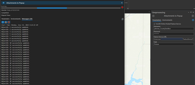

DickieRigdon
@JakeSkinner   Hi Jake, the workflow is working great with the manual token refresh and I'm going to see if the organization can run the Task Scheduler as well.  One question, if new records are added to the ArcGIS Pro dataset, will my same toolbox work with the updated data?  The dataset will constantly grow in entries every month.  I'm building a web map app that will publish the data.
JakeSkinner
@DickieRigdon yes, as the dataset grows, the field you created to store the URL will update each time the script is executed.
