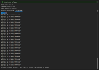

@DickieRigdon line 34 is attempting to generate a token, so I believe it's something with your username/password.  Are you using the following username, DRigdon_cadoc?
The tool worked for me successfully:

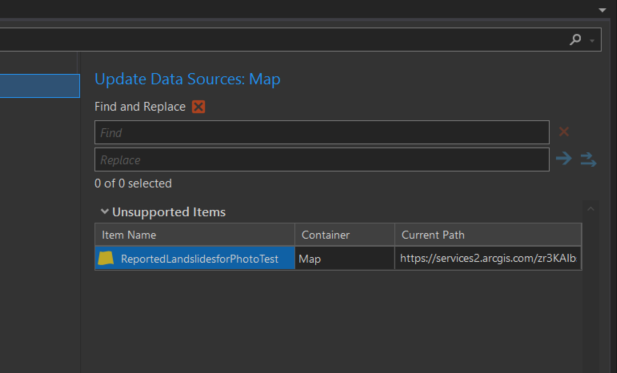

@JakeSkinner  Yes, I'm using that user name.  I think I've somehow lost connection between AGOL and Pro for the layer.
lost connection?lost connection?

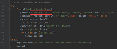

is there a way to write the script to query by kewords and only create URL for those with that keyword?  I have a signature and a photo column in the attribute table, which have keywords of 'photo' and 'sign'.  Can i filter or query or only build an URL for the 'photo' keyword attachments.
JakeSkinner
Esri Esteemed Contributor
@MarkGambordella, yes you can update the where statement on line 87:
MarkGambordella
would i just write is as  'where':'photo'    or do i need to write it a differnet way and say keywords: photo.
Im really new to coding and using python and could use the help.
