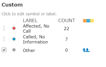

But for some reason, if the value for 'Called, Left Comments' is never appearing on the map, instead those customers are grouped into "Other." Even though in the symbology panel "Other" has a count of Zero.

Not really sure how or why, but it suddenly works after saving and refreshing the page for the 3rd or 4th time.
The symbology panel/tool must not be automatically refreshing the available data, even after data is edited or changed, and even with a refresh interval of 1-minute set.
