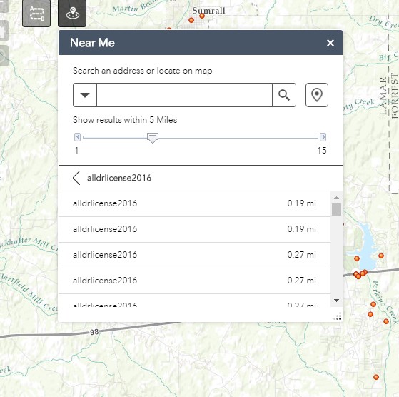

I'm trying to create a search with ArcGIS online that allows users to select what kind of store they would like to go visit; equivalent would be a "select by attribute" in arcMap.
For example; show me all of the grocery stores within 15 miles of me using the search nearby widget. It returns a popup with a list of matching returns, but instead of listing the name of the feature layer I would like it to display the grocery store name. As far as I have seen, I am unable to see where to make changes to this popup. Does anyone have experience doing this? Or even a better way of doing this. I would like for it to just be a drop-down of possible attributes rather than a search bar. Thanks guys

  If you are using an AGOL or on premise portal for hosting your app then you are out of luck. If you use WAB Dev then you can make a change in the Near Me widget code to make it do what you want. Currently the widget is coded to show the layers title though.
