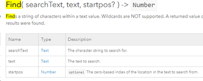

This looks good although is there another way to fetch the values in the table other than a relate? Like doing a search or find? The relate takes longer and I did not think it would be necessary since the specific values to search for in the table are being are already provided using the intersect. I did find a "find function" in the arcade documentation although was not sure how it could be implemented or if it even could be used in this way. Any insight you have would be great.

 Find is for finding sub-strings in strings. It won't help you with feature sets.
