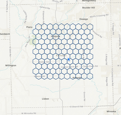

This, I think, is the method we want. Let's give it a try. I have a layer of hex bins that cover my county. I have a view layer defined as shown above, being a subset of bins in the center.

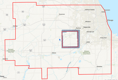

For that omitted portion, I used the polygon JSON of a donut feature which encompassed my entire dataset, the "donut hole" being the portion I wished to exclude. Mine was created from "surrounding counties", so it was more complex than yours would need to be.
Going back to my view layer after this, I now see the following features, along with the AOI:
Perfect!
To further refine this, you could also change the spatial relationship to "contains", to grab only those features fully contained within the donut polygon supplied.
It's a lot of work, but in short, it's definitely possible.
