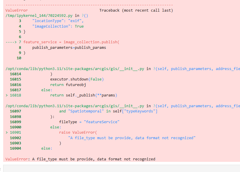

Suppose to publish the Image Collection as a feature service, but returns with the error "A file_type must be provide, data format not recognized"
publish_params = {
    "name": "Field_Photos_Feature_Service",
    "locationType": "exif",
    "imageCollection": True
feature_service = image_collection.publish(
    publish_parameters=publish_params
feature_service
