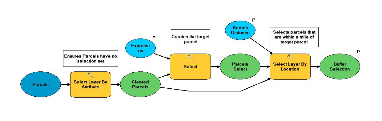

I’ve been playing with geoprocessing services and slowly getting them to work how I want, but I’ve run into a bit of an issue and am curious if I'm missing something simple. Seems like it shouldn’t be that hard, but I can’t figure it out.
So this works fine, it creates a map service of all the parcels within a mile of the target parcel. The issue is I need it to save or download a dbf or csv of those parcels' attribute information to the user’s computer. If I try a table to table tool and set the output location as a parameter it works fine on desktop, but when I turn it into a service it will only save to the servers directory. I feel like this should be a fairly easy and common workflow but am stumped. Anyone have any experience with this?
