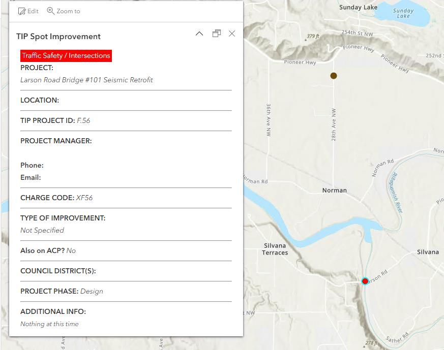

This may or may not work for your situation but you can try reinforcing the connection between the popup and the map's features by carrying over the feature's color into your popup. Here I have popup for a layer of capital projects where each type of project has a different symbol color. Using Arcade, I look at what type of project it is and then color the background of the header text with the same color that's used in the map.
BenClark
I like this improvisation, Steve, and I might try to go this route as well. As of right now I'm dealing with 39 different values, so it won't work for now, but we're looking at possibly bifurcating or trifurcating those 39 into super-groups that'll indeed be color coded. Your workaround might work there very well.
