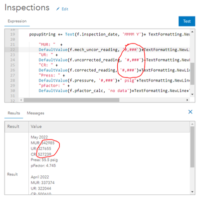

I modified the form to suit my data, but cannot get the numbers to format correctly.  Any ideas?:
bdewitt_olsson
@JasonCyphers The second parameter in the DefaultValue function sets what will appear if there is no data. It is not used for formatting. Try replacing
DefaultValue(f.mech_uncor_reading, '#,###')
with
DefaultValue(Text(f.mech_uncor_reading, '#,###'))
JasonCyphers
@bdewitt_olsson perfect, thanks.
I got an error when using "DefaultValue(Text....))", but using "Text(f.mech......)" worked.

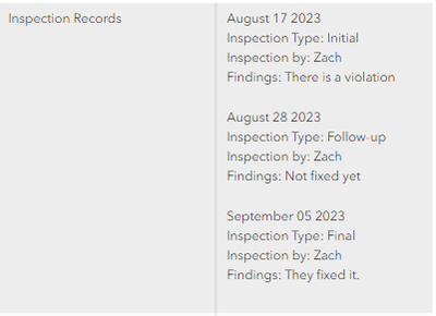

This is such a super helpful article and really fills in a gap that ESRI hasn't seen fit to address properly. Thanks for your hard work and guidance Gee! I'm running into one problem though that I hope someone here can help me with: When I tart to build the popup string, I have no problems with the code running properly, but it seems to return a maximum of four attribute fields. I copy and paste several more instances of the attributes in the popup string but they don't show. I've tried re-ordering them as a test, and whatever order they are in, only the first four show. See example code block and resulting screenshot below:
// Write a script to return a value to show in the pop-up.
// For example, get the average of 4 fields:
// Average($feature.SalesQ1, $feature.SalesQ2, $feature.SalesQ3, $feature.SalesQ4)
//set variables. First variable is the unique ID that is shared by the primary and related data. Second variable is calling the related forms as a FeatureSet
var codeGlobal = $feature.GlobalID;
var relatedForms = FeatureSetById($map, "189ffea4bbf-layer-175")
//create a filter statement where the maintenance form GUID = the Tree Inventory GlobalID
var filterStatement = "CompRel = @codeGlobal"
//a maintenance form equals the table run through the filter
var inspForm = Filter(relatedForms, filterStatement)
// Sort related features by oldest to newest
var relatedDataSorted = OrderBy(inspForm, 'InspDate ASC')
// Build the pop-up string by iterating through all related features. Add or subtract new lines in the popupString as needed from the related form.
var popupString = ''
for (var f in relatedDataSorted){
    popupString += Text(f.InspDate, 'MMMM DD Y') + TextFormatting.NewLine +
        "Inspection Type: " +
        DefaultValue(f.InspType, '') + TextFormatting.NewLine +
        "Inspection by: " +
        DefaultValue(f.InspBy, '') + TextFormatting.NewLine +
        "Findings: " +
        DefaultValue(f.Findings, '') + TextFormatting.NewLine +
        "Investigation forwarded to: " +
        DefaultValue(f.FwdTo, 'Not forwarded') + TextFormatting.NewLine +
        "Forward date: " +
        DefaultValue(text(f.FwdDate, 'MMMM DD Y'), '') + TextFormatting.NewLine +
        "Owner action required: " +
        DefaultValue(f.OwnAction, 'None at this time') + TextFormatting.NewLine +
        "Owner action deadline: " +
        DefaultValue(text(f.ActDate, 'MMMM DD Y'), 'None at this time') + TextFormatting.NewLine +
        "Date letter sent: " +
        DefaultValue(text(f.LetterDate, 'MMMM DD Y'), 'Letter not yet sent') + TextFormatting.NewLine +
        "Date of final inspection: " +
        DefaultValue(text(f.FinalDate, 'MMMM DD Y'), 'Final inspection not yet conducted') + TextFormatting.NewLine +
        "In compliance?: " +
        DefaultValue(f.Comply, '') + TextFormatting.NewLine +
        "Action taken by city: " +
        DefaultValue(f.CityAct, 'None') + TextFormatting.NewLine +
        "Date forwarded to city attorney: " +
        DefaultValue(text(f.AttyDate, 'MMMM DD Y'), '') + TextFormatting.NewLine +
return popupString
//the default return is "Norelated forms"
Any ideas why that might be?
