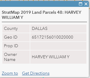

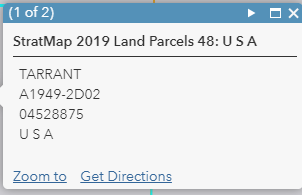

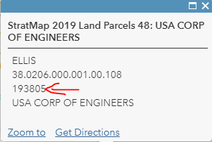

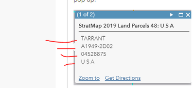

Using the table format and arcade expressions, is it possible to not have empty spaces in a pop-up. For example, if I have values A, B, and C. If they all list for one point, but B and C are present for the next point, can I remove the table row for A to be replaced with B as the top row in my pop-up. I am trying to alleviate a messy pop-up with empty rows in the presentation of data.

Can anyone help me I am trying to hide empty fields both the Arcade expression and HTML script are right but they are not displaying the field names:
Arcade expression:
IIf(IsEmpty($feature["prop_id"]), "", "Property ID")
HTML
pop up:

utenalarosa
@XanderBakker
If the field is empty I want that field to be skipped and write the next one which it does that like in the image below the prop_id field is empty so it's not displaying
while the one below has pro_id field
what i am missing now is the field name or alias displaying before the information.
This what I get by following the link you sent me it's not hiding the prop_ID:

utenalarosa
@XanderBakker
It's is working in my code it's hiding the empty field but it doesn't work when I try following your link instructions, in my code what is not working is the fact that is not displaying the field name like in the example
where the red line are in the image below should say County: geo_id; prop_id; Owner name
I try hard coding the field names in but then they still show Prop_id even when is the empty.
Thanks,
Teresa
XanderBakker
Esri Esteemed Contributor
Hi @utenalarosa ,
Is it possible to have access to the map and underlying data? I am pretty convinced that this is data-related, but without access, there is little that I can do. If you are able to share, please create a group, share the map and data to the group and invite me to it using my AGOL identity "xbakker.spx".
