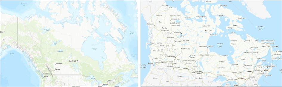

All map projections distort the earth in some way, and your map may require a different projection, depending on its focus. For example, the Web Mercator projection greatly distorts area, which is particularly problematic when displaying Canada’s northern regions. This is apparent when you compare the following maps:
While both maps are displayed at similar scales, each one uses a different map projection: Web Mercator (shown on the left) and Lambert Conformal Conic (shown on the right). You can see that Lambert Conformal Conic is a more appropriate projection for a map of Canada because area is not distorted the way it is with Web Mercator.

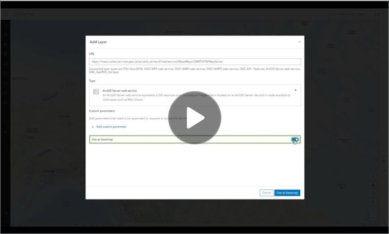

To learn how to change the projection, watch the following short video or follow the steps outlined below.

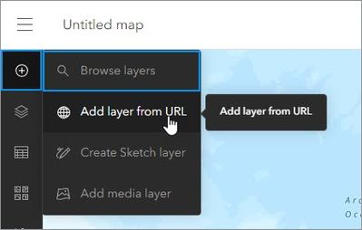

1. Start a new map in Map Viewer.
2. On the Contents (dark) toolbar, click Add.
3. Do one of the following to find a layer in the desired projection to add to the map:
  • Click Browse layers and search for the layer you want.
  • Click Add layer from URL and enter the URL of a layer from the web, such as an ArcGIS Server web service.

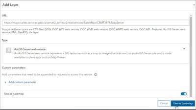

4. Do one of the following to add the layer as a basemap:
  • If you browsed to the layer, click its name and click Use as basemap.
  • If you entered a URL, turn on the Use as basemap toggle button and click Use as basemap.
The layer is added as a new basemap for the map and the map is now displayed in the projection of the new basemap.

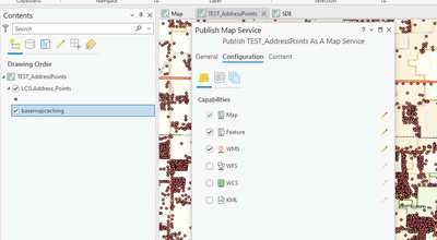

When I am in Pro.  I have only one layer in the map.  that layer is set to NAD 1983 StatePlane Louisiana South FIPS 1702 (US Feet). but the basemap that it is on is web Mercator.  when i publish the map service, feature service to AGO it stays as Web Mercator and returns x,y based off of that coord sys.  Our data field in the attribute table for this layer needs to the new data points match the old points which have x,y coord stored in NAD 1983 StatePlane Louisiana South.  I tried writing a script within the form for the editable feature for x, y but the coordinated will not match up with what we have been populating when the feature was in ArcPro.  WE are sitting up an Address issuance tool.  the original add on tool was created in ArcMap.  But our organization is no longer using Map and has switched to PRO.  I thought it might be easier to setup an editable layer in AGO for adding new addresses.  but i need for the x,y to stay the same as previously issued. thanks
Do i need to publish the web service as a WMS in addition to a Feature Service.

It sounds like you may be trying to share data in a specific coordinate system but ArcGIS is reprojecting the data into Web Mercator as it shares it.
If I've understood the problem correctly, I would say no, you shouldn't have to publish a WMS. It should be possible to share a feature service in whatever coordinate system you want. I suggest that you ensure that your map (not just the layer) is set to NAD 1983 StatePlane Louisiana South FIPS 1702 (US Feet) before trying to publish. That might solve the problem. If it doesn't work, you can try publishing via the Share as Web Layer tool instead (on the ribbon, click the Share tab. In the Share As group, click Web Layer).
